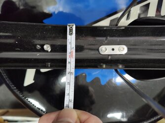

Off topic but I wanted to ask @Nebulous and @Paul_Smith SRCC what size Bontrager NCS mudguards did you get and what was their actual width? I want the 28-35mm version but have only 42mm clearance

Hi, I didn't explain myself properly.
I meant my bike has 42mm clearance around the fork and seatstay crowns but the Bontrager NCS guards don't actually say how wide they are, just they fit 28-35mm tyres. They might be 45mm wide and too big for my bike.
I have just measured them for you, across the bottom they are 45mm, allow for the fact that the stays and forks will probably flare out slightly then they may just fit, it will depend exactly where you have taken your 42mm of course. The guard depth to where I have taken my measurement is about 20mm.
