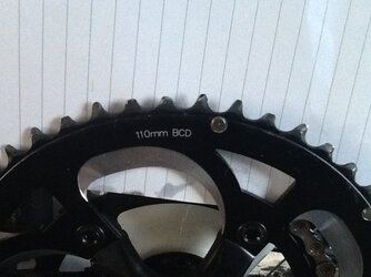

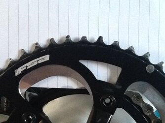

Hi all,
Got my new bike on 1st August, Boardman Ltd Ed Team Carbon, however I pulled it apart again for a clean today and noticed the Large chainring looks really worn already, there's no issue when riding no skipping of the chain etc, its done 270 miles in a month.
My giant defy I had previously did nearly 1000 miles before I had to change the rings.

Looks like you have a chain problem. I can't believe you only got 1,000 miles from a ring, something is going wrong. Clean and lube chain regularly, use sensible gears, check chain for stretch?
Anyway that wear after 270 miles is a warranty issue if you bought it new.

Erm..... what is wrong with that chainring?
You do realise that the teeth on chainrings are not all the same size and shape right? They vary around the ring in order to improve shifting performance!
I think someone doesn't realise what a chainring is meant to look like!
@jonbrackenridge
The paint has worn off slightly from wear but that is purely cosmetic. There is some friction between the chain and crank/cassette teeth. Perfectly normal.
As Rob says above, the teeth are shaped this way to improve shifting. Again perfectly normal and IMO your kit seems in fine condition.
If it all works as fine as you say, then put your mind at rest.
I honestly didn't know that, so thanks for the info :thumbsup:

My chainrings look a bit like that, and have from new.
Had to replace a middle one at 3,000 after I bent it when cleaning a load of gunge out, apart from that I usually reckon on 9 to 12 thousand miles from a middle one. The others last forever. Bike's done just over 4000 and I have a spare middle one for fitting in roughly 9000 miles time!
