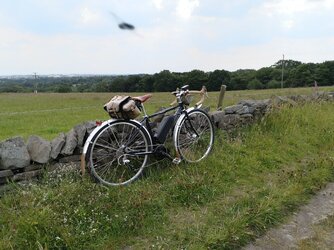

Show us your Spa Wayfarer
Vantage

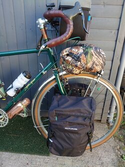

As of this week, it's now an ebike.
mickle
mickle
innit

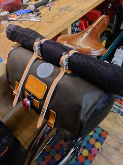

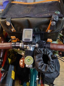

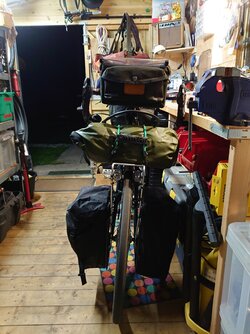

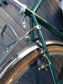

Jeez. It was supposed to be a simple job, buy a new frame and chuck all the bits over from the existing bike. That was January and here we are. The Blackburn Custom Low-rider I was so delighted to find a NOS example of hanging on the wall of a local shop (after being an absolute bastard to fit to my fork) - does not place the bags where I want them. The whole point of a low-rider fork is to lower the centre of gravity to improve the handling. A properly set up low-rider hangs the bags behind the steerer, which makes a bike so stable you can ride all the way to Timbuktu no handed. So I sold the low-rider for what I'd paid for it and spent weeks trying to order a Giant Rack-it front rack. A farking saga in itself. Anyway. I now have a set up which uses a £20 Brick Lane Bikes front rack to fill the space between wheel and bar bag, and a nicely made low rider £23 which places the back hook of the bag behind the fork where it belongs. I will at some point link the front racks together for a bit more rigidity, but it's perfectly good as is. A bloody bargain if you exclude the fannying about.
Now that the racks are finally resolved I can wire the dynamo lights, gadget charger and trip computer. At which point I might go cycle camping.

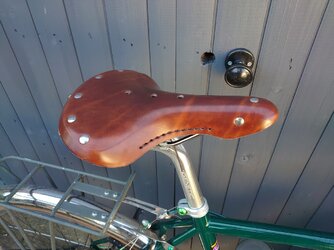

New (wider) Spa Saddle. I didn't get on with the ENE which is basically a B17 clone.

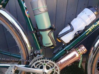

Stronglight CS, Syncros 46, Stronglight 34, Pace 24
12/32 SRAM 9spd cassette and chain

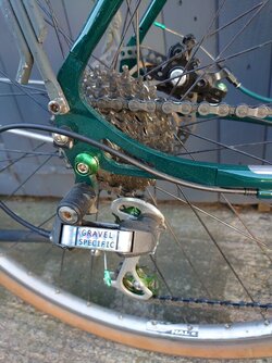

Suntour XC 9000 rear mech with alloy pulleys
