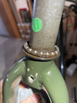

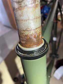

I finally got around to disassembling the bike for bottom bracket replacement, servicing the headset and eventually painting.
Replacing the bottom bracket was a bit of a hassle because the (aluminium) bearing on the right side had gotten so rusty that my Shimano wrench slipped and stripped the head. Since fitting the bottom bracket last year I had ridden the bike through flooding several times both last year and this year so it did not come as a huge surprise. In the end I had to ask my local bike shop to take it off for me which they charged me 20€ for. I guess I could have bought the more expensive hollowtech tool for that price.
I wanted to service the headset because it had been making funny noises for a while and I knew it had never been serviced because I am the first owner of this bike. Disassembly proved difficult because the steering tube was fused pretty thoroughly to the headset and I had to soak everything in WD-40 over night before I was able to pry the top cap off. The bearings were completely dry, cages rusty and the bottom race is pretty rough.
I would like to replace the bearings and races but I don't know which FSA parts are compatible and I could use some advice if anyone here has experience. Can I throw sealed bearings in there or do I need to go with the same caged bearings? Would it make sense to buy an entire headset (this one looks like it could fit https://www.performancebike.com/fsa...eadset-black-11-8-141-2210x/p1275829?v=314075) and use it for spare parts?
shu2gaV7
Regular
Nevermind, I just saw that it's not easily possible without replacing the entire headset so for now I will remove the rust, replace the bearings and drown it in grease before I put it back together.

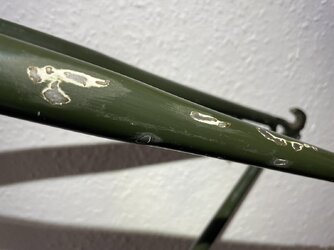

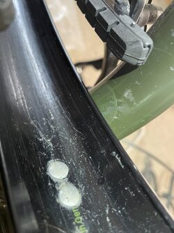

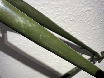

Took me a couple of weekends but now it's finally back together and I just completed a successful test ride.
Here are some shots of the paint job, the shade of green does not match exactly which is easier to see in bright daylight but it's close enough for me. I sanded down the affected areas a bit first and then applied a single coat of paint.
While I was preparing the frame for painting I found that Fuji had put a sticker on the drive side chain stay for protection but the paint was chipped anyways. Removing the sticker took a lot of scraping with a plastic spudger but I decided it would be a good idea to apply a new one and I ended up getting this kit from Zefal. It also came with stickers for the top, bottom and steering tubes and I used some of the smaller stickers to protect the frame in the places where the mud guards touch.
