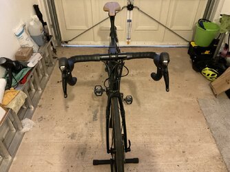

Can you take a photo of the front of your bike and post the photos on this thread? Maybe then some of us could suggest specific advice.
Thank you for your help.
Thanks for the photos. It appears that there are some spacers to raise the bars. It is a long stem, so I'm wondering if fitting a shorter stem would help you. Then your torso wouldn't be so leant forward and placing so much weight through your hands.
I'll put a photo below - this stem in the photo is probably overkill, but it does illustrate what could give you a more comfortable position.
