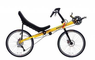

How does one go about securing something like this for instance?

I think I would make sure the seat bolts are security bolts and then feed a cable through both wheels and under the seat. I'd probably wrap the cable tight to the frame under the seat and maybe also find a U lock that was small and tight to the frame tube.
However, being me I would weld a loop to the frame for locking up.:biggrin:

I remember one trike rider (think it was tigerbiten) locking his bike to a road grate. I think you could probably do that here over the frame between the bars and the saddle.

D-lock around the steerer area then a cable lock or chain for the wheels. Sure you'll be able to get the d-lock off if you remove the forks & boom but you'll have to cut/remove the gear & brake cables all of which will be a lot of work for someone trying to steel the bike.

I use locking wheel skewers to protect the wheels, I have a triangulated frame so locking the bike in general is not an issue, for the pictured bike I would pass the d-lock around the frame between the seat and the shock then to something solid like a sheffield stand.

I'd lock the bike up with a D-lock where the red line is:
It makes attacking the lock much harder than between the seat & rear wheel.
