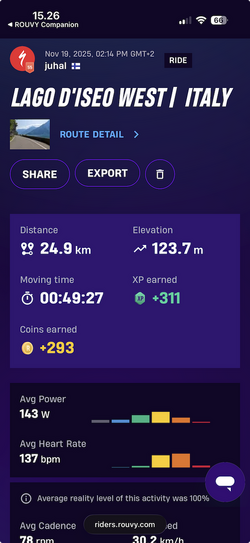

Lago D'Iseo done.
I was surprised there were 2 different ant connections. When I switched to the one on the screenshot it was more realistic without as much sawtooth. More like the Neo was.
