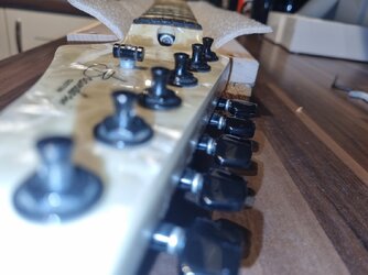

spend £3 at screwfix and if it doesn't work you might have to spend and extra £30. Better than spending £30 when the £3 tool might have worked. If the screwfix tool is a standard nut extractor with a left hand thread, i can't see how it won't work.
My concern is that if I use the regular nut extractor and it doesn't work, then I've already ruined any chance of the tapered tool engaging. The next option would be to dremel out a slot for a flathead screwdriver.

Another option that I'd try is to replicate the stewmac tool with an old oversized allen key... give it a taper on a grinding thing if you've got one.
The stew mac tool is probably cheaper than a guitar tech. I was quoted £50 for a nut!

I'm happy working on it myself, same as my bikes. Particularly this one, it's a bit of a labour of love. I abused and neglected it for so long, it's only proper that I should try and put it right.
The truss rod nut is the limiting factor which is why I'm doing it first. If I can't manage that then I'll have to have a rethink. New neck or even neck and body, and transplant the hardware. Would be a shame though, and more expensive than I can afford right now.

Here's the neck in question and you can see how the wrap is impeding access to the truss rod. You can fit a stubby allen key in there at the correct angle but nothing longer. I may need to Dremel away some of the wrap to get proper engagement but as you can see it's not exactly perfect to begin with so it's not to the detriment of the instrument. I did buy the cheapo Screwfix extractor tool but I've since had the kids all day and it's ADHDed itself out of existence so the next job is to find where I put it. The most time consuming part of any project...
