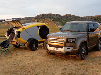

A few pics from Achmelvich shore campsite, amazing site right on the beach.

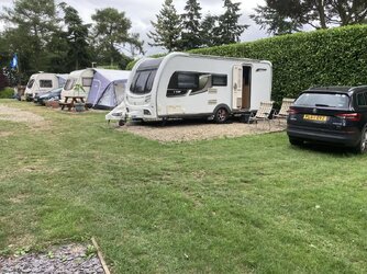

We had it there about 13:15, & set up
Well, not quite, it's fine fore & aft, but need to have a mess around next weekend to level it laterally
Saturday 1st
Father-in-law & I went up late morning
Levelling a BWSOW laterally, with due regard to need to fit the hub mounted wheel-lock is like 4-dimensional chess!
1. Get the correct position for the lock, & it’s not level
2. Position correctly for lateral level, & the lock is nowhere near!
3. The motor-mover works on both wheels, but tries to swivel the ‘van, as it climbs the ramp
4. It seems okay, then the motor-mover is swung off the tyres, & the handbrake set, it settles............. start again at #1 :cursing:
Solution;
- Hitch up to the car, as a solid brake point
- Release BWSOW handbrake
- Jack up the offending side
- Rotate the wheel to correct location for the lock
- Lower corner-steadies
- Recheck with spirit-level, on 'van floor
Job Done!

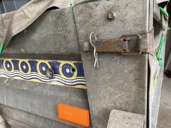

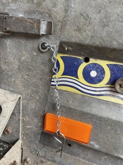

Just a little job, that I actually meant to do after the last time I used the trailer
The 'over-centre' latches have R-clips through them to prevent an unintended opening of the tailgate
Last time, instead of putting it in a pocket, or in car, I dropped one on the floor, into a muddy puddle, & had to feel for it, thankfully finding it
So, I decided to chain them on
I had intended using bath-plug chain, but couldn't find any locally (not even at B&Q, or Wickes, just the ball-chain type)
Hence my trip to Wickes, in the rain, this morning, for the lightest duty chain they had
I also wanted some 'double ring R-clips', to avoid the zip-ties, but can't find any
I can get them online, but only need 2, so not buying a bag of 100, just for that

I've got some large fishing connectors if any good?
Screwfix and toolstation sell plugs with a chain...... may or may not be more expensive and you'll have spare plugs you'll never need :laugh:
All I've seen are the 'ball-chain' type, in both (paper) catalogues
I've
They'd have to big! ^_^
Without going out to measure the 'over-centre catches', I put them at about 1 & 1/2 inch deep
EDIT @ 21:14
I had a look in my Indespension catalogue, they have 'double-coil', but when checking the price online, they only have 5mm varients, & at a silly price each; https://indespension.co.uk/trailer-...accessories/trailer-fittings-hardware/r-clips
