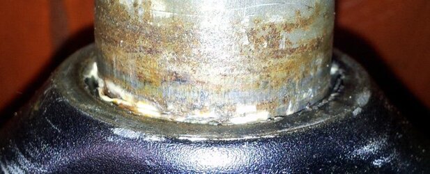

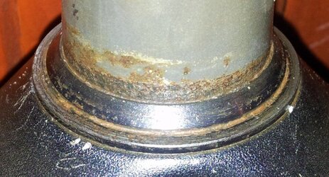

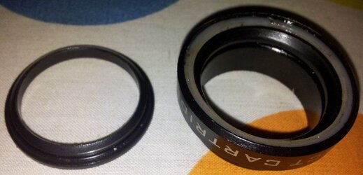

Right I have set that I think will do the job.
However, when I came to fit it, I discovered something that I need a bit of clafication on.
The headset came with a lower crown race. My old headset lower crown race came off without any effort (it was quite loose). I thought the lower crown race normally needed quite some effort to remove?
But looking at the forks, it appears that there is something that looks a bit like a crown race still on the forks. But it could just be they way the forks are made.
It can be seen in the pictures.
Yep, that bit on the fork can come off. On the opposite side of the fork (in the picture) there may be a little notch to get a flat bladed screwdriver in. Tap it with a hammer and it will come off fairly easily.
If you look closely there may be a very slight taper towards the bottom of steerer tube...
The bit on the fork is the original crown race and was made for sealed bearings (which you have in your new headset).
They have simply popped another crown race over the top - one that took caged bearings. It will never have seated correctly - hence your problems.
I agree - try and prise it off.

Nope, no notch. I tried to see how tight it was by trying to move it with a pipe wrench. But it will not move. It really does look like it is part of the fork assembly to be honest.
I really can't see that it is the lower crown race as the lower crown race is already off. Unless for some bizzare reason it had 2 lower crown races on it (from and earlier bodged headset change maybe?). But that is unlikely of the headset is a bontrager one which would suggest that it is the original factory fit.
It's supposed to be tight. You won't (and shouldnt) get it off by hand or twist it with mole grips etc. Screwdriver and hammer and spray are your friend! Don't be shy!!

It does look as if the fork still has a crown race fitted.
They can be a ba***rd to remove, but will suddenly 'go'. A thin screwdriver tapped in under the race will generally start it moving (where the white scratch is on the right hand side of your photo). You may need to 'tap' fairly hard!

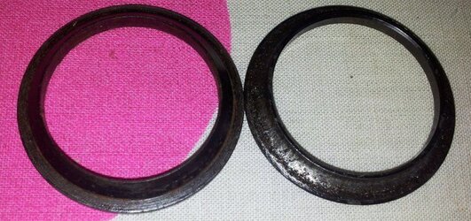

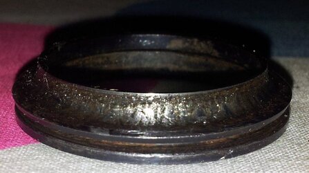

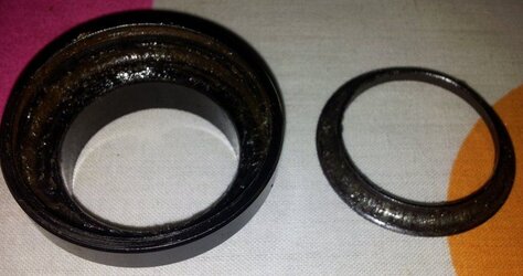

Took it to the LBS. He refitted the "second" lower crown race to how it was and it actually spun freely on the suspected other lower crown race, He said that it was very strange that the lower crown race should not be lose like that. After some inspection he said that it was a lower crown race and should be removed. He carefully tapped a stanley knife blade below the crown race. After a few rounds of this, he had a big enough gap to get a screwdriver in and off it came. So it would seem that for some reason, someone had fitted a new headset in the past and put a lower crown race on without taking the old one off. The third picture shows how they would have sat on the bike. No wonder I had the problem with water ingress in the lower bearing. Thanks guys. I will now fit the new headset. Hopefully, this is the last of my troubles with the repair.
