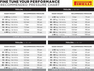

I have an app, which for your weight and assuming 10kg bike suggests 68 psi front, 72 psi rear, might give a bit more comfort.
I run 28mm 60psi rear and 58 psi front, 69kg
Interesting. I'm just going by the recommended pressure according to Pirelli. See attached.

26mm width & 80psi is on the cusp of what is practical to run tubeless. you ideally want a wider tyre (assuming it will fit) so you can run at a lower pressure.

I assure you this is not the "practical" limit/cusp. Many pros are running 25s tubeless at these pressures, or higher.
As far as the OP's pressure is concerned (running 26mm Pirelli P Zero Race tyres and 76kg), the Pirelli chart suggests 93psi. This does seem real high for tubeless (seeing the risk of snake bites is nil).
In addition the load on the front wheel is max 45% of the total load (rider plus bike) so (rule of thumb) 10psi difference rear/front.

That calculator above suggests I should be running at 63 front, 68 rear for tubeless, but the Fusion 5 tyres I was using have a minimum pressure of 74psi. Even for tubed tyres it suggests 71/76, which seems low to me. (I'm 89Kg, my bike is 9.4Kg)
