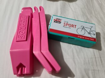

None. Ride on on the Kenda tyres. Are you repairing your own punctures "very often"? I thought you had bought neither levers nor a puncture outfit.
Just got both tire levers and puncture repair kit through the post.
Waiting to get bike cleaning kit (muc off) so I can wash the bike before completing the puncture repairs.
