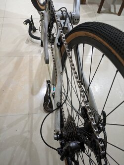

Got the Schwalbes in Halfords, ÂŁ43 ea.
I know, I was very lucky with the Swallow, bit scuffed but still very usable. Amazing what you can pick up here for cheap.
The bike is very unusual in that all the control cables are completely sheathed end to end.
