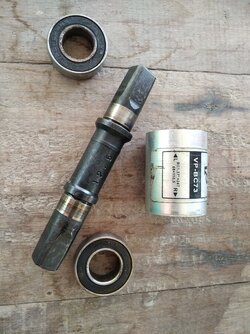

Bottom bracket bearing replacement, inspired by RJ the Bike Guy over on the tube.
This particular BB was running as rough as, well, don't no what really.
The non drive side cup pops off easy enough, but the drive side need a few taps with the rubber persuader
The spindle is held firmly, and a lot of tapping needed to get the first bearing off. The spacer pushes out of the way enough for access.
Second bearing like so. Again, lots of tapping and it eventually gives way.
So here we are, all disassembled.
Here's the second bearing going on (sorry, forgot to photo the first one). A socket is used so as all the hammering is to the inner race.
I've not put the cups back on as you can see. On most BB's, one side of the spindle sticks out more than the other. This gives you two choices when deciding which side to have each cup, and so two different chain lines.
These are just unbranded bearings, so no idea of quality or longevity.
Most of my builds are done on the cheap, and often recycled into other projects, so nothing fancy needed.
That's it for this one, it'll go back in the BB tub, ready for a future project.

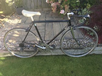

Bar tape? Pshaw! Why not do a bit of ‘snagging’ while contemplating the relative merits of electrical tape, cheap foam tape and foam grips? Spending the time instead finding the front and rear brake pads could do with adjusting, the front mech refuses to drop the chain in and the cable retaining bolt won’t hold the cable. So, spray oil and a good working on the pivots (ooh, err), rummage in the bolt jar for a bigger retaining bolt to tap in, and give it overnight to soak before deciding whether a replacement mech is needed.
THE END IS NIGH!
It transpires that the Campag front mech is banjaxxed, on account of its pivots having more wobble than a table of jellies and a spring which doesn’t. So, replaced with a Shimano from the shop scrap pile ; tick, tick, tick. Came down on the side of electrical tape bar tape, in fetching black, and a couple of mismatched bar plugs from the Pit of Despair.
So here it is, Raleigh Reynolds 501 something; Shimano 200 front, 300 rear, mechs; Campagnolo brazed -on down tube shifters; Suntour Perfect 14-24 5 speed block; Custom 52-40 chain set; what look like Modolo Mach 1 callipers and levers; unbranded alloy stem/bars; unbranded saddle and alloy post; Pelissier hubs; Michelin Select 70lc x 25 tyres. At one time someone’s criterion rocket, now up and running again. Destined to be given away as a ‘work bike’, as it surely will not sell.
