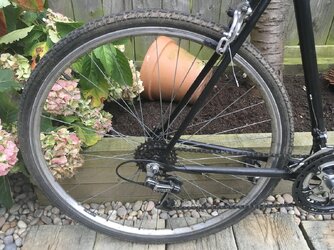

If anyone asks if you can fit 700c x 38mm tyre on a 70’s Dawes frame, the answer is ‘yes’ - if you can move the derailleur back to allow the axle to sit at the ear of the drop-outs. In my case it meant drilling and tapping (thanks Ali) a hole for the derailleur securing bolt further back on the drop-out.
