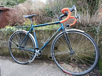

iandg
Dropped forks out, cleaned and greased headset and re-assembled. Swapped the stem for a shorter one, fitted new bars (Ergotech City Cruiser), needed a 26.0>25.4 shim, and the original brake levers and grips. Part fitted original mudguards and brakes. Not enough clearance for 28Cs so got the wheels out of my bikeability teaching bike (with 25C Schwalbe Marathons) and swapped the cassettes. Added the front brake cable.
Build so far
Build so far
Nice bike, and I like those bars.
