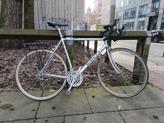

Ross on Wye
Nice bike and looks very well looked after. I refurbished a Galaxy at work today and it certainly wasn’t as good as that.
It's not bad. I never rode it back from Hereford yesterday though, because in the first few hundred yards it became apparent that the gears jump badly, probably due to wear on the cassette. Plus it was very cold and windy. So I feebled out and got my wife to collect me instead.😳
