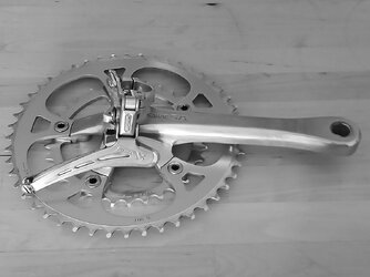

With looking forward to Spring, the 531 framed early 80s demi-course was for fettling:
* Aimed to reduce the gearing with a TA 33T chain ring (original 36T) on the Sakae double chainset, but it required 1mm spacers at the spider for good alignment.
* VXS (mid cage) rear derailleur then wouldn't handle the new wrap well - swapped out for a VGT Luxe GT. This derailleur was about three continents away from connecting at the Gipiemme dropout - making it impossible for the angle adjust/ B screw setting. Maybe designed for stamped/ longer dropouts?
* Third time all good; Cyclone II GT fitted & working well- has a notably reduced distance re angle/ B screw than the VGT.
* VX front derailleur installed
* New Paselas fitted

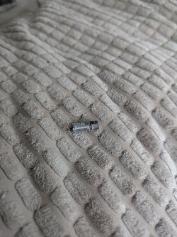

Initially, fish were swimming, as they say. My world was at peace, and steadily lit. But then something changed, in the air: since those heady early days, the lamp became increasingly wobbly. Unpredictable. No, I didn't confront the problem. Yes, I allowed myself to live in denial. Then -yesterday- CLANG, CRUNCH, BOINK:
The light lives on, (and is destined for a less dramatic environment on the handlebar of my commuter bike). I blame myself- stupid stress-raisers caused by serrated brake washers. Also, erm, aliexpress may have been involved.
Anyway I bought another light. I'll try hanging it off my computer mount. See how that goes.

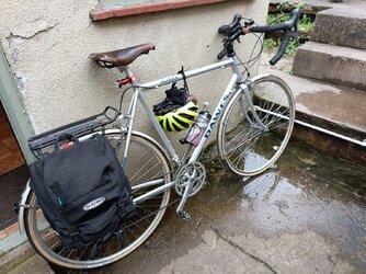

I have to commute to work today, 26km over the hilly Forest of Dean, and I have to take a change of clothes. The only bike in the stable with a pannier rack and mudguards was my fixed wheel, and frankly I couldn't be arsed with fixed today. So I've dug around in the massive pile of crap in the shed, found some mudguards and fitted them to the Dawes Audax I bought last week. Bingo! A winter commuter with gears.
