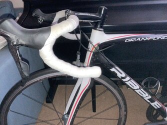

Fitted some new bar tape on the new to me bike I purchased at the weekend. Firstly the old bar tape was re wrapped tighter then double wrapped over the top with some Charge U Bend tape that I’ve had for years. New end plugs fitted together with some red finishing tape for a change.
I usually try and avoid white tape as it gets dirty so quickly but it does look good with the white saddle and the black & white paint.
Next job is to swap the pedals, I have a choice of Look Keo, Shimano M520 or maybe the bargain Willier SPD’s that I recently purchased from Banana Industries.
@Spiderweb
I thought that was my Gran Fondo at first, due to the colours & Ritchey stem

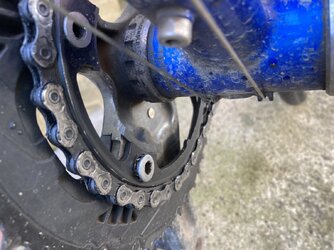

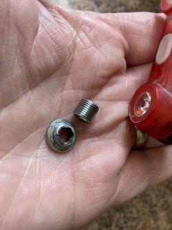

Realised on my ride home from work, through the woods, that a chainring bolt was loose
My thought when l got home was to use some brake-cleaner on it, & the thread, then thread-lock (as it’s possibly one that’s loosened before)
However, on removing it, the bolt was broken
The first three, l found in the shed were old pattern (2-piece) so to my surprise, a different size
Thankfully, l did have a couple of same thread, from previously replaced chainrings (it was cheaper to buy a complete chain set than rings separately)
All good now!

Funny thing.. exact same happen to me a couple of weeks back. First time I've ever had broken one. Luckily I had a spare in my box of bits.
I’ve had a few go over the last 30+ years of ‘365 commuting’
I wonder if salt spray eventually gets to them, despite being wiped with diesel when the chain is lubed & mudguards?
