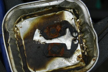

I've been working on my neighbours bikes. One of them I could hardly push as the brakes were seized on.
I haven't worked on disc brakes much , but I was surprised to discover what was causing them to stay on . I soon found out when I removed the pads.
Rust!
The corrosion had swollen forcing the pads against the disc.

Illaveago
New caliper and pads I would think! What a bad state the bike isn’t have been in!!
The rear set I managed to clean with rust remover. The front pads were replaced as one of the pads was concave! The pad must have jammed but the piston continued to bend the pad . The calipers cleaned up .
Rust!
Not a frequently used bike then.
