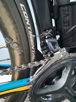

The front derailleur on my 1994 Giant CFR Pro Series was a Shimano RX100, this worked with combined brake/shifters but when I converted to down tube shifters the spring tension was too strong and the arm from pivot point to cable attachment too short.
Because of this the lever could not hold the derailleur in place on the big ring and would slowly creep across.
My fix for this was a Shimano 600 Ultegra (Tricolor) derailleur, a 6401 model.
This model has adjustable spring tension as it's designed to be used with both types of shifters. It also has a longer arm so there is much better fine control as the lever moves further to make the derailleur travel.
This photo shows the original derailleur in my hand and new one on the bike.
You can see the difference in length between the pivot points and cable attachment points.
