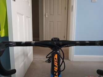

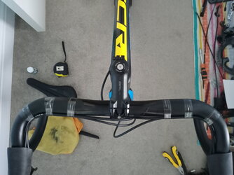

Can I just say, for those that are considering getting that Chinese or any other frame and building a bike - be mentally prepared for internal cable routing. What a faff! I started doing it yesterday and couldn't go to sleep before getting it done, as a result stayed up until 1:20 am :crazy:
Can anyone tell me if this looks remotely right:
625342 625343
I did it the same way it was before, the handlebar is new and the stem is used but almost new. That angle on the cable where the handlebars bend looks quite aggressive - is this how you do it?

I think that’s looks really tidy. You need to be able to turn bars in both directions and see if you have enough length on the cable Housing. But it looks very smart.
Magnates and long nose pliers can make internal routing less painful.

Looks tidy.
For awkward routing
You try sewing cotton, fed in one hole, use vacuum to draw other end thru, then attach stronger pull cord to string
