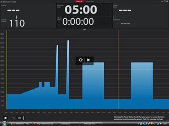

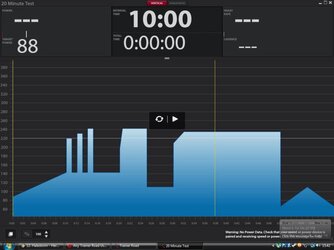

I am not sure about the Trainer Road FTP test, it is not the same as the ones recommended by Allen and Coggan or those by Joe Friel all of which require at least a 20 minute TT effort on all variants. The trainer road version is a couple of hard intervals and then a pair of 8 minute efforts right?

In the 20 minute test ( the name being a clue) the test period is 20mins. The 8minute test has a pair of 8min segments. There is a 2x20 test too

The workouts list isn't available unless logged in so I can't link you to them

Can you confirm, the 20 min test is, a 20 min warm up, 3x 1 min spinning at 100 rpm with 1 min rest between, 5 min easy, a 5 min balls out effort, then a rest for 10 mins then a 20 min TT effort, then a cooldown of 10-15 mins?
Yes except,the last effort is 5mins with a ramp into the 20min test period. Cooldown is 10mins between 66 and 110W @my set FTP
