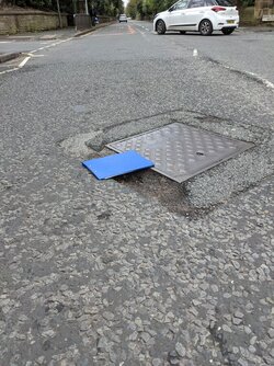

Went to look at the pothole and am going to attempt to claim via the council.

That's not a pothole, that’s a trench!

Unfortunately hasn't so not sure if that will lead to any claim being rejected.

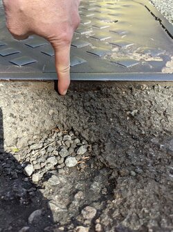

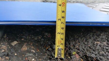

On advice I tried to measure it today, hard to do as it's a busy road.
Don’t think you’ll have a case if council not previously aware unfortunately
