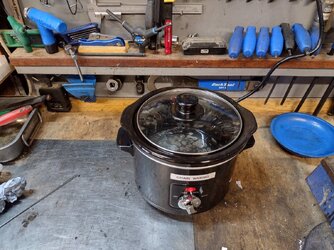

Can't comment on the Boardman as I haven't been out on it yet - but one of my other bikes (Van Nic Ti road) has been ridden with a waxed chain for several hundred miles and the chain has remained very clean and (although I may be imagining it) seems to be smoother running. As long as the chain doesn't get too dirty (wet) then it should last around 3-400 miles before re-waxing (the original pre-first wax clean to remove oil - or original grease on a new chain - needn't be repeated)
Waxing the clean chain only takes about 5 mins to remove/refit the chain - and about 35-40 minutes in the slow cooker, no need to watch it! - and about 20 minutes for the chain/wax to dry and cool down. I hang the chain from its midpoint on a nail above the bench above the slow cooker to catch any drips. The chain ends up as a "stiff rod" with the wax coating and needs manual "relaxing" before re-fitting.

^_^ - simple dear boy, buy your own slow-cooker . . . mine was <£10 at Argos ! It lives in my workshop, on the bench ready for action - clearly labelled for the avoidance of doubt.

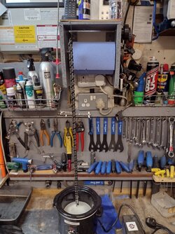

A further refinement to my chain-waxing process - I've fashioned a "tool" from an old spoke - it's about 8cm long and has a bent-round hook at each end - I hook one end (with a narrow opening in the hook) to the middle of the chain - then when the chain is in the wax I can position the open end of the hook so that it pokes out of the wax . . . making it simple to pick up the hook with pliers at the end of the waxing period - I then have a nail on the tool rack above the bench (higher than half the chain length) to hang the chain straight with it over the pot to catch excess wax before it dries. [I know that needs a picture - but it's pretty obvious]

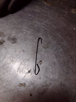

A picture is worth a thousand words:
The hook (the almost closed end is where the mid-point of the chain is fitted before immersing in the wax:
The chain having been removed from the wax pot - hanging over the pot to drain excess wax - you just about see the hook on the nail in front of the blue paper towel roll [This picture is "staged" with a brand new chain that I'm about to fit to a customer's bike, and the wax in the pot is cold]

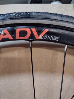

Not a good start to the year - while cleaning the bike this morning I found that the rear wheel rim had a split at one of the spoke nipples - bike has done 3,300km, all on road. Bike was purchased in Feb 2022 so not a lot of chance with warranty, although I have asked Tredz . . you never know!
Has anyone bought a replacement rear wheel? - and if so what?

Thanks - I'll take a look - I'm considering swapping the front too while I'm at it . . . the OEM wheels with the "offset spokes" don't seem to adhere to logical engineering principles to me with the potential uneven "sideways pull" on the spokes.
