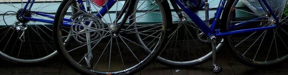

So, for me, it's a standard double for road, and a standard double plus granny for touring/audax/long distance.
so you would prefer the bike on the left, i take it :smile:
