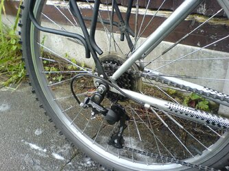

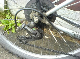

I am sooooo guilty.....:blush:. Got my bike in Feb as i planned to do a Tour.... So i did lots of training and stuff before the trip and just kept on top of chain..... (as in...i cleared bit of gunk out and oiled it!!!). So lots of training and one-track mind for the trip.... I do the trip and all is well.:thumbsup:. Bike was good and no problems. What i had done before the trip was reset my bike computer so as to keep an acurate record of my miles etc.... But the computer still records total milage since fitted... (the day i got the bike!)... So after a forum conversation the other day i thought 'oh oh!':cursing:... How many miles has bike done since Feb? And i havnt done a full chain clean???:eek: Ermmmm! Its just short of 1900 miles! I had no idea i had done that many miles? So today i spent 2 hours giving my bike my undivided attention! Cleaning and scrubbing. It's loads better and i have redeemed myself :angel:.... Just!!!!! DSC01001.JPG DSC01002.JPG

Do it quick! Looked it all over and everything seems ok and fine.... But if i had done another tour with plenty of weight before winter?:whistle: Well then i reckon it would be expensive!!!!! It took me 2hrs! Not coz i felt guilty and took extra time over every little bit? Took that long coz it was soooo bad!. i am doing it every 300 mile now as a rule :thumbsup:. What do you all use to De-grease????
