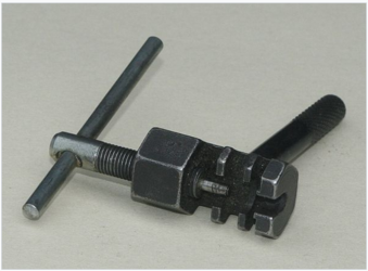

Do link extractors fit all types of bike chains?

Nah, @midlife is right. Alot of chains now use mushroomed/peined pins. They wreck the outer plates when pushed out so a quick link is needed to rejoin.

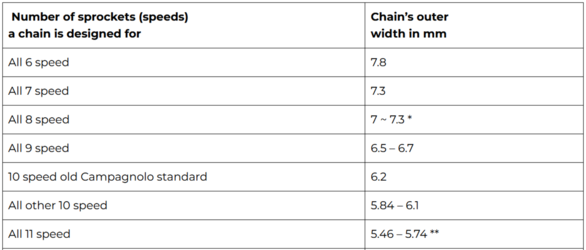

What is the physical difference? Is it that a 11 speed for example would be thinner links (not shorter links) than a 7 speed?
The outer dimension of an 11sp chain is less than a 8sp one (see table below - 1.8mm). And I assumed your "on the MTBs that I used to ride" you were talking about 1990s MTBs (chain tools designed for max 9sp).

So, in respect of 11 speed, it is likely that a new connecting link would be required.
Also as 11 speed are well established, are we saying that the industry now produce a link extractor specifically for 11 speed now.
I join all my chains with a 'quick link'. Shimano chains come with a special pin to join them. SRAM and KMC ones come with a 'quicklink'.
Some 'quick links' are in theory 'one use' ones. I normally fit and remove mine up to 3 times per chain, though.
Different speeds have different 'quick links'. but they will work, as a temporary fix, one speed up (ie a 9sp will work on a 10 sp chain etc).

I found the Cyclo tool wasn't man enough for 10 speed and above. More sophisticated tools also have a peening setting for mounting such as Campag chains (which have a special pin that has to be peened on fitting). This is the one I use, which is as good as the official Campag one costing three times as much - https://www.wiggle.co.uk/bbb-proficonnect-chain-tool-btl55
9, 10, 11, 12 (is there a 13?) speed chains all require a joining link specifically for that individual size but as @Ajax Bay has said, we can usually get away with small discrepancies in size. I ran an 8 SPD KMC link on a 9spd chain without issue.

You could always drive the rivet out using a masonry nail as a drift and small nut as a bolster, just like my Dad taught me when I was very young :okay:
I was around thirty when I discovered there was actually a tool specifically for this job and life became easy. :dance:
