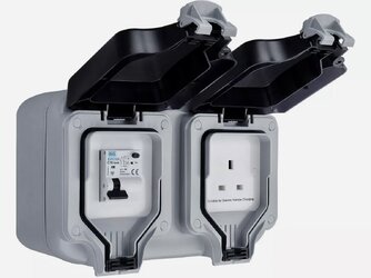

Like most car owners, my car spends 95% of its life parked on my driveway. That’s more than enough opportunity to keep the car in a state of charge that covers all my needs. (And I exclusively use a granny charger.)
I had an external socket 👇 fitted in the front porch for £140, including parts. It’s a doddle to plug the car in overnight whenever it needs a boost.
This. Except mine's even lower tech, running from the garage under the garage door. It's all terribly unscary.
