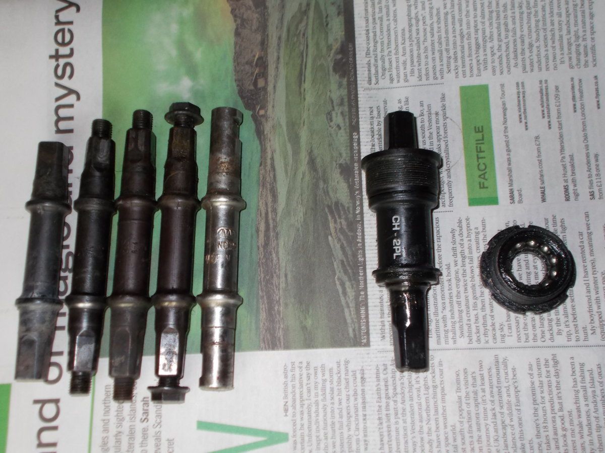

I'd have thought you'd need a very short bottom bracket 103mm'ish as it's dependent on the chainset. I've got one of these http://www.wiggle.co.uk/halo-aero-track-rear-wheel/ on mine with an old Campag wheel on the front.
So how do you measure or work out the bottom bracket length you need? I assume I buy frame and chainset then offer it up and guess?
raleighnut
I'd go for cups and a loose shaft/bearings and if I hadn't got one the right length to get the chainline right have a rummage around Johns (Bob Warner Cycles) drawer of new alternatives. Last time I did that was when I built up a Raleigh 3spd, here are the ones that weren't right for the job.
Hampshire
With a 120mm standard 'track' OLD and a 'track' chainset I'm pretty sure a 102/3mm BB is what you need but I'm only going on experience of the two fixed bikes I've built, someone better informed may be able to offer a more scientific method of working it out. I'm currently running one of these http://www.wiggle.co.uk/token-tk867-iso-square-cromo-axle-bottom-bracket/ (no I don't work for Wiggle, the one it replaced was ten quid from Planet X but they were out of stock when I needed one).

@Fab Foodie has just bought one of them. Does our Abingdon correspondent have any Bottom Bracket length advice to offer?
Nope!
Not got that far. I was going to contact Singlespeedcomponants where I'll get the chainset and take their advice.
