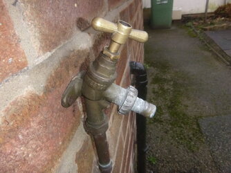

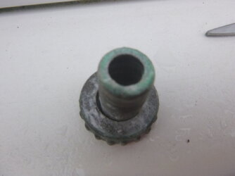

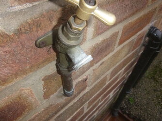

Hi Everyone, Here it is and I unscrewed the nozzle for you to see.
Right - I see
In my opinions - for what it is worth - you have 2 choices
1) use the tap as in picture 3 and get a Hoselock (or knock off version) screw on thingy. This will give you a standard female Hoselock connector one on each end of the hosepipe will allow the hosepipe to connect to the tap at one end and the powerwasher at the other
2) a standard Hoselock connector (female) on one end of the hosepipe to connect to the power washer and bare end of the hose at the tap end
Then push the hose over the tap as in picture 2 and tighten it on with a jubilee clip of a suitable size
