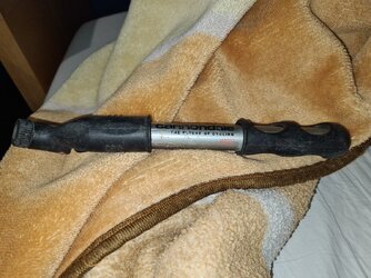

I have a cannondale old schrader mini pump. Don't know if it's fully working or not. I say fully, because I had a track pump before and it wouldn't pump my tires up despite pushing air out when tested with no tire attached. My lbs tried my pump and said it's not working. So I asked him to throw it away.
I've now discovered that with a presta valve you have to REALLY push down the pump head on to the valve or it's just VERY hard to pump and no air goes in.
The pump head has to be far down the valve. Thanks to the diagram on my Joeblow packing, I discovered this. Spent over an hour trying to figure out why I couldn't pump an inner tube that was in my room, or tire on my bike, till I decided to look at the packaging that I was oh so close to throwing away.
Maybe he just didn't fully put the head on so it looked like it wasn't working while I stood there, so that he hoped I would buy a new one? Idk.
So the mini pump I have, should I just buy a schrader to presta converter? The longish tube type adapters I mean.
Don't have a schrader to test this pump on.
Or should I just buy a new one?
This mini pump has no mount. I plan to perhaps keep a mini pump in a pannier bag anyway. Might keep the frame clear for mounting my bike lock or water bottle holders.

Get a Lezyne mini pump, can do either presta or schrader, come with mount which attaches to bottle cage mounts under the bottle cage. Has a flexible hose, better imo that the types where the pump clamps to the valve (just screws on, but be careful if you have the horrible inner tubes with removable cores such as Continental!)
eg, get large size, the longer the pump the easier to get air in
You've only just bought one.
5th item on your list.

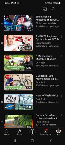

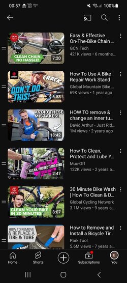

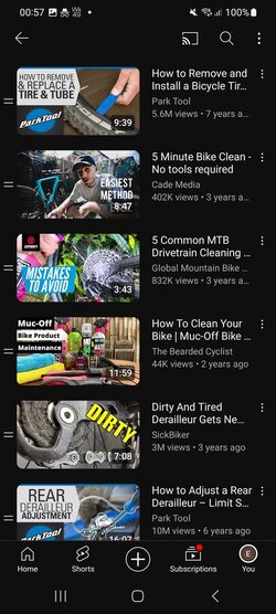

I've watched tons of YouTube videos. Pretty much all of them use muc off tools and sprays. None only wipe the chain with lube and a rag.
