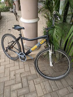

Cycleops
Accra, Ghana
The young lads down here favour this low seat/high bar configuration on their bikes. You can't see the bars very clearly but they are cowhorn type with a bar across and set vey high and long stem.
Nothing to do with comfort though.😉.
