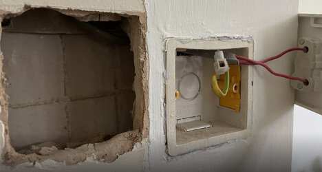

Loose plug socket cover - threadlock?
Fancy spending 20 mins on this one?
I was going to replace it with a double, but realised the butchering I would need to enact to get that box off might take the entire wall šŸ™„
I’d love to meet the YTS trainee who installed it originally: shake him warmly by the throat 🤣
Gave up and put a single back with a USB in…

I have a double socket where the threads must be a bit chuffed on the metal "Box in the wall" as you can screw the screw in but every now and again it slips (I have tried a new screw, its the thread in the box that is chuffed). do you reckon a dab of threadlock on the screw will help? or does anyone have a neat solutions short of changing the wall box, which is a bit of a nuclear option.
Bodge job don’t do it ! Get it replaced, easy enough but switch power off !! If not very sure at all get a sparky in !

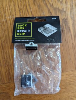

It wasn't an urgent job, all wedge / bodges failed so sorted with two of these.
Top job.
