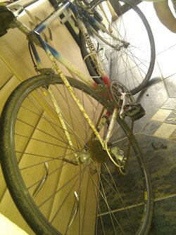

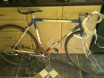

This is my old bike from about 20 years ago I recently dug out of the shed & stuck new tyres on. The frame is in poor condition and the bike is far too small for me but riding it has given me a real want to have a good bike.

Oh the poor baby :smile:
