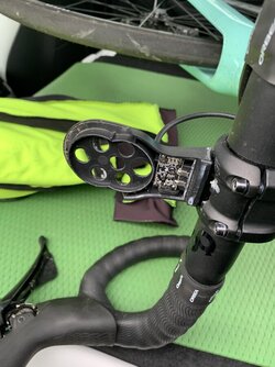

Warning about mounting Garmin Etc on front light cradle on Orbea Gain. The cradle is not strong enough to take the weight of a Garmin or other GPS. I’ve had my orbea gain just 3 months and destroyed the from light cradle and lost my Garmin 1030. It just fell apart on a shaky decent at speed. I figure the little Polestar unit is about as heavy a unit that can be put on this light cradle. See YouTube Lake District cyclist guy just posted a video of his Garmin doing exactly the same. Then a second video of him buying a replacement front light cradle and fitting it himself. The cheap plastic can not hold the cantilever weight of a heavy GPS unit. See my destroyed light cradle below.. on the plus side it’s only £45 to replace off the Orbea web site. So not the end of the world. Going to attach Garmin to the stem.
