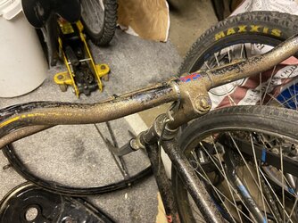

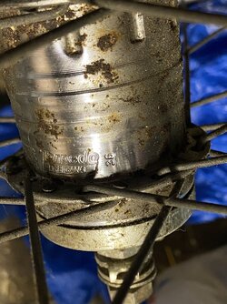

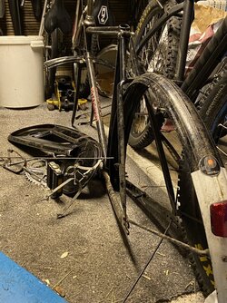

My friend gave up on this rod braked Pashley so he’s let me have it. The seat post and saddle were stolen ( I presume it might have been a Brooks) so that’s one of the items I need to source.
It looks complete although a bit crusty in places but I wasn’t expecting a concourse project.

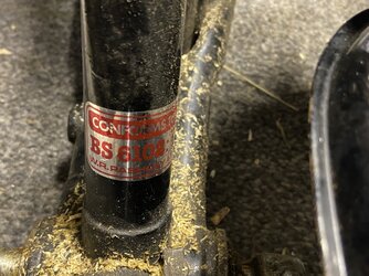

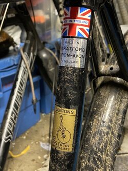

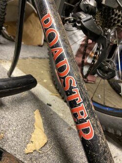

Does anyone have any experience on ageing this bike, the three speed hub isn’t dated like a Sturmey Archer but I get the feeling it might not be as old as the rod brakes make you think

Looks "interesting" - I'm never quite sure about Pashleys; I like the retro aesthetic but sometimes it feels like more style than substance. I think they have some provenance though.
The earliest iteration of BS6102 I can find is 1981; suggesting this is no older. Raleigh made the Superbe with rod brakes at the same sort of time, although this was also more of a style-driven re-issue than a continuation of a long-running design..
Wil be interested to see how you get on :smile:

Thanks for the info, I had my suspicion it was younger than the rod brakes suggested which doesn’t bother me as I still wanted a rod braked bike to play with.
The internet isn’t much use in finding out much about the model or year but I will crack on with what I have and see if it works

Very nice and interesting project. Pashley themselves might be able to help you date it if you write to them and give them the frame number.

Bolted some bits on today and found a seat post. The gear shift is tight as hell so I’m not sure if there is a way of fettling that.
I’ve seen a few old Brooks saddles with big springs that would be in keeping with the look on various auction sites.
I think it needs a big carrier at the back as well

@skudupnorth - I recently acquired a similar rod braked Pashley roadster to yours. I've tried contacting Pashley on several occasions to get confirmation on the build date, but have yet to receive a reply in over a year. As best I can tell by other images and the component selection with the Sachs "Dreigang" (three speed) hub & Shifter and the Union dynamo, it's a mid-1980's model, around 1984. They made a similar model in the 1990's called the "Propsero," but I'm not sure if it was called that in 1984.

I had a suspicion it was a later “ retro” style bike which doesn’t detract the appeal of a rod braked project. It’s a tatty thing but already it’s growing on me. I’m hunting for a reasonably price Brooks B.66 sprung saddle now but that might have to wait until after Christmas
