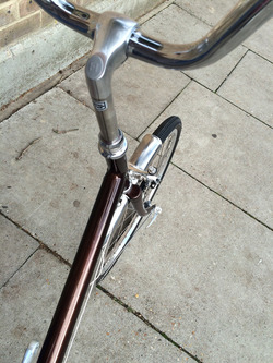

This may be too late for you, but I had a rusty Dawes kingpin powder coated and have been commuting on it regularly in London since last Christmas. I haven't noticed any problems with rust returning or the paint chipping.
Before:
After:
Powercoat:
There's a detailed thread about it on LFGSS.

Great job - ! :thumbsup: Wouldn't believe it's the same bike - ! Good to see you've dumped the steel rims in favour of alloys. Much more efficient braking, especially in the wet - !

That looks pretty darned stunning Betty! I'll check that thread out sometime, I'd like to read a bit about your bike.
