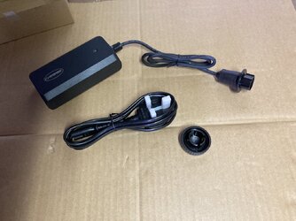

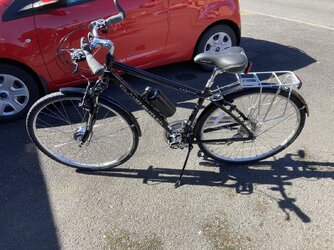

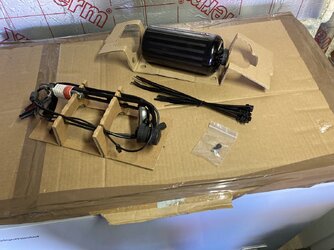

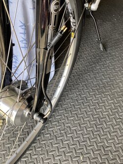

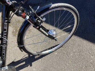

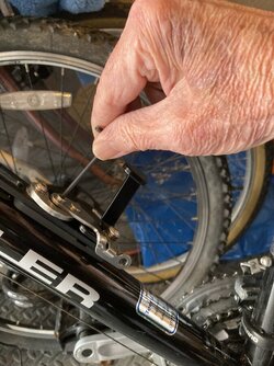

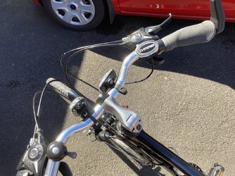

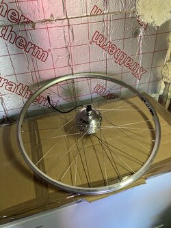

I fitted the Cytronex C1 kit a few months ago and I can recommend it. I have posted my fitting story on this forum. It has changed my cycling life now no hill stands in my way.

The Cytronex C1 battery, 180 Wh Li-ion, weight is 1.5 kg and easily removable from your cycle. Fits in place of the water bottle so bike doesn’t look like it’s an electric bike.
