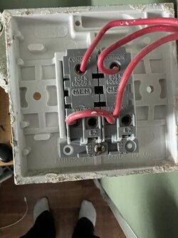

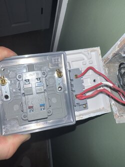

What’s the best way to bring the old method into this new switch?

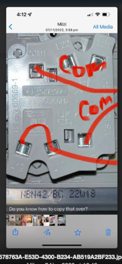

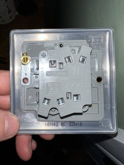

Also this other combo ?

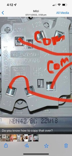

Just checking to make sure it’s right that’s all. :smile:
That looks about right to me, for the second combo, just wire up one side.
Edit to add: Pick the brown side, that's the side you wire up in the same way as the original socket.

So one in Common and the other 3 all in the same.
So one wire in live in and 3 in live out?
Or one in live out & 3 in live in?
Or did you mean put 3 in live in & 1 in neutral next to it?
