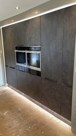

You will probably need a bit more than 16A supplies for ovens. I guess you already knew that as you mentioned 10mm cables. It’s correct that you won’t need to replace the CU just because it is plastic. It’s new installs that need to be metal. You have two spare ways at 7 & 8, so you should be OK for the two additions. You already have a supply marked “cooker”. Does this mean you will have three ovens installed? Is this a dwelling or a cafe? Just curious.
Well it’s a micro & oven and the one already labelled will have an induction hob so I do have 2 spare breakers.

I’m getting two new ovens in a new kitchen in a few weeks. Cables probably 10mm need to run a short distance through the roof from the main consumer unit board.
The worry is my consumer unit is made out of plastic and is about 17 years old. I’ve heard new regs mean you should have a metal box now?
Do I need a new box for the electrician to sign off my hob & oven?

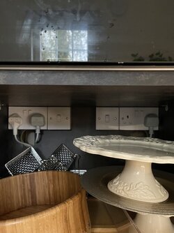

Ok we had our kitchen replaced back in summer with two ovens and two warming drawers added ( posh as f… I know and costly if all running ) . Those are wired into the kitchen ring main on 16 amp switches sockets , the drawers are 13 amp plug sockets. Our induction hob was wired in the other side with the old oven cable extended. So zero work done at the CU box , however sparky did say it should be upgraded to provide better protection on all circuits .

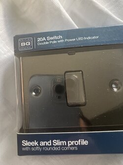

Hi folks. I’ve got some more sparky chat.
I bought some switches ages ago that are overkill. Double pole. Probably can’t take them back now. I want to use them for bedroom light switches. I know they are meant for appliances with heavy loads but am I right in thinking they will be ok to use just for the ceiling lights? Here’s a picture.

They will be fine, if they can switch 20A they can switch 3A
