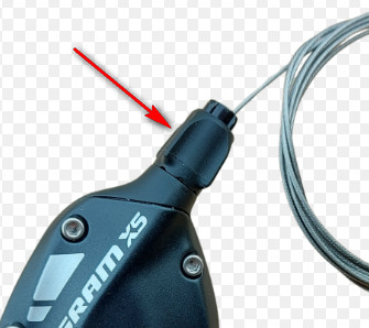

The other thing I am seeing is that I can cause skipping on the old chain by a slight misadjustment of the cable. Not sure of the proper name
https://peter-ftp.co.uk/screenshots/20260501158705616.jpg
I may also need a new cable, which looks a messy job. This YT bike needs some special tools already and I struggle with it. This again shows how close the tolerances are on this stuff. The upper derailleur wheel is as closely centred as I can see on the cartridge but < 1mm causes skipping. I wonder whether this is driving the wireless gearchange market :smile: In mechanical terms this is poor engineering.
