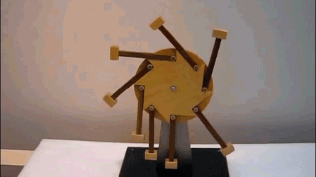

Click here to see this and other super wheels in action:
Doubtless all powered by cold fusion. This must be why my legs get hot riding up hill on a winter's day. Will the SuperWheel be taking its place amongst them? Note the name of the web page where they appear.
