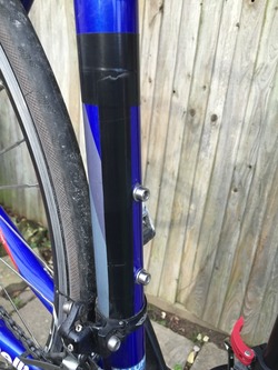

You may have done this but I can't see this in the images. If you don't the sand and grit will slowly disfigure the paint where the mudguards are fixed (given you haven't got eyes on that frame).

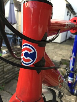

Ive also got some damage where the brake cables and pump and lock holder touch the paint, so added some gaffer tape today:

When applying tape cut the edges neatly and trim the corners off. PVC tape comes in all colours to match the bike. PS clean the surface before applying.
Tape is just electrical tape for protection - I'll remove it when I stop commuting, or race. Think I've got some spare transparent tape from the raceblade kit.
