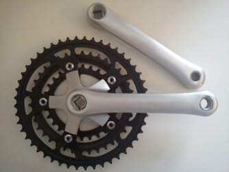

Noobish question. I'm going to convert my 70's road bike to SS. Since it has cottered cranks I've bought another used cotter-less crankset on ebay. Since chainrings are bolted by 5 bolts I assumed it's comes from a road bike. I haven't noticed third chainring then. Now I started to doubt if triple crankset was a good purchase. I know I should have done my research earlier...
It's a Exage 300LX crankset just like the one in picture bellow.
Is such crankset usable for SS conversion?

Should be fine. Get a set of single chainring bolts, and lose the other two chainrings.
If you're using a singlespeed conversion for a freehub rear wheel, then sorting the chainline out is as simple as a simple thing. If you're using a freewheel, things get a touch more fiddley.

I've just converted an early nineties Dawes Racing frame and to keep costs down I used a double chainset which I then dropped the inner chainring from, I'm sure you could do the same with a triple. The outer ring will be just a little further outboard of where mine is. Luckily my chainring bolts tightened up still despite the missing ring, but you can soon buy shorter ones if need be.
Like TheDoctor recommends I bought a Surly spacer kit to fit on my freehub and this allowed me to perfectly align my chain in the straightest line possible with the front chainring. I looked at several kits and the surly one offered the most amount of spacers which allowed for greater fine tuning and much more chance of a perfectly straight chainline.

Just in case someone has same question. Finished converting my bike yesterday and had first ride on it.
Had to grind of mounting points of third chainring. Bought a 103mm BB (needed one anyway because of cottered original crankset). Also took back wheel to LBS for re-dishing. That's it, got near perfect chainline.
