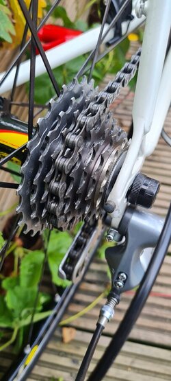

My 80's Throwback build was almost perfect except that the 13-21 uniglide cassette on the back and 42-53 front limited the grade of the hills I could enjoy it on.
630155
In my younger years I'd take on any hill with this combination, now at 50 not so much.
They haven't made uniglide cassettes since the early 90's and if I could find one with a 28 I'd be paying $200 or so for a NOS example.
The difference between uniglide and the current hyperglide cassettes is the splines on the hub.
630156
It's hard to spot in the photo but the uniglide's (top) splines are all the same size, the hyperglide has one spline that's a bit smaller.
630157
In the bottom of this photo you can see where I've filed the tab flat for the smaller spline so that the hyperglide cassette fitted on the uniglide hub.
630158
The other difference between the two types is that the uniglide uses the smallest cog to lock the cassette onto the hub.
I found an older cassette with a 12 tooth small cog so I used this with the new hyperglide cassette which is now 12-28 instead of 11- 28.
A new chain to handle the bigger cassette and job done.
End result- a bike that's more usable and still retains the beautiful Shimano 600 tricolour hubs.

I like your creativity!
I hope that freehub keeps working for you now.
I can't take credit for the idea, my local bike mechanic mentioned it was a common fix when they stopped making uniglide.
The other option was modifying a freehub- a lot more work.

My Dura Ace 7400 is still uniglide. Ive nipped out the Dremmel on a 26 tooth hyperglide sprocket to fit. I'm running 13 x 26 on my Ribble, 600 tricolore, but Mavic wheels so hyperglide. Going to move the Dura Ace to 13 x 26 as its on 13 x 24 at present.
The rear mech won't take a 28 i don't think.
I agree its hard work with a 39 x 24 bottom gear. That extra 2 is just enough. Gone are the days doing Winnats on 42 x 21. Wasn't fun then when I was a racing snake.

Yes, it's all the way back, there's no adjuster screws in there.
With the height of me on the bike I'm happy to have the ever so slightly longer wheelbase.
All my road bikes have 28 as the largest cog now, it makes the transition easier between bikes and I can swap wheels if I need to at a pinch.
26 is a good max size if you can get it in there.

I had moved both road bikes to 24T before I busted my spine, but I've lost a bit of fitness since, which I'm working on getting back up, but having ridden MTB for 5 years, I tend to spin more, so the 26T has made the steep stuff a bit more tolerable.
Currently got a bid in on ebay on a new HG 50 13x26 for the bike above, as thats running HG and UG sprockets. Will save the UGs for the Dura Ace bike

I'm doing the same, spinning a bit more than when I was younger.
All the best with getting your fitness up, I imagine it must be a difficult recovery from that injury.
How do you like the Dura Ace? It's always seemed out of reach for me but one day I'll build a bike with it- a goal for the future.
