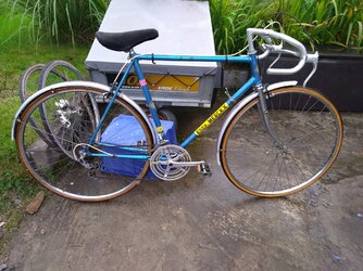

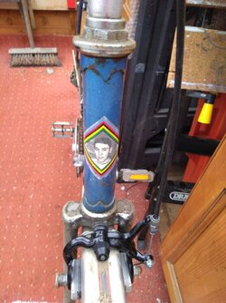

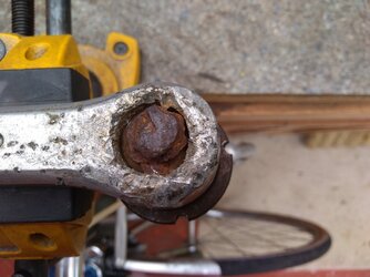

I'm aware that the Falcon Merckx bikes came in different flavours. However, this was difinitely the "Christmas Catalogue" model; basic Huret derailleurs and steel wheels. At some stage it has had replacement forks, which turned out to have the wrong size bearing race - a situation rectified by over-tightening. The steerer tube is bent and I'll leave you to take a look at the state of the crank. Oh, and the cranks were different lengths. If I can find a suitable front fork, I have the bits to build it up. At the moment it's in bits in the shed.
