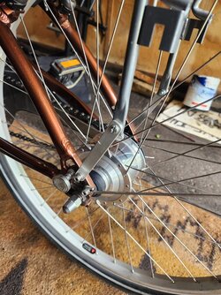

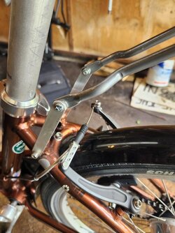

My heels were hitting my saddlebags I put on this Dahon bike I just got, so I made some aluminum extensions to get the bags 4 inches higher and one inch back so now there is enough clearance for my feet when pedaling.
Drzdave58
I think after a few miles that rack will move. It’ll pivot on the bolts.
That is possible. I will be keeping an eye on it and if it does i will seek a better solution. Update: been riding this regularly for a week and the rack hasn’t budged at all and it’s loaded up with several lbs. of gear.
so far so good.
