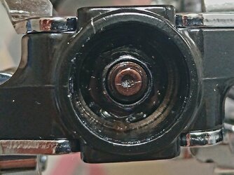

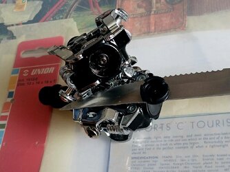

Recently bought these new SPD type pedals for in a £10 sale (including cleats): https://www.bananaindustries.co.uk/...ts/wilier-pd-sm01-mtb-spd-pedals-ball-bearing
The bearings were set too tightly & there was a design feature that wrecked my brain for a long while*: no space for needle nose pliers or the smallest flat blade screwdriver to hold the cone in place while the locknut is adjusted by an 8mm socket.
Two points: no washers between cone/ locknut & an anti-clockwise thread on the right pedal.
All 4 sets of loose bearings were syringed with new grease, thin washers (from V-brake blocks) were fitted over the cones before replacing the lock nuts & the anticipated challenge of bearing adjustment.
What finally worked was backing the cones way out with tweezers, and with much retry, retry, retry, managing to guess where the fully tightened locknut & an ideal bearing preload could be set. The second pedal was much easier & now both have no lateral play and are spinning very freely. Soon they'll be attached to some cranks & out into the world.
Probably made by Wellgo - time will tell how durable they are. It was a rewarding test of patience.
* I'm not gifted at all in finding the answers for problems in bike mechanics. Up north they would say: "Yer no' the shiniest spanner in the tool kit."
