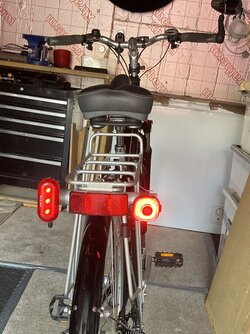

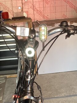

Fitted the Magicshine magnetic bike lights, with a bit of fiddling about at the carrier end.
